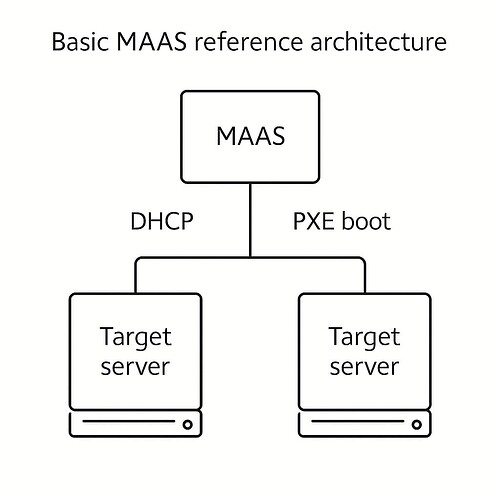

1. A potential MAAS test setup
One way to try MAAS is to have a separate network with a switch, router, and several servers. One runs MAAS, the rest are targets for provisioning. In this tutorial, we automate all of this in a virtual machine with Multipass and use LXD to simulate machines MAAS can control. The setup looks something like this:
